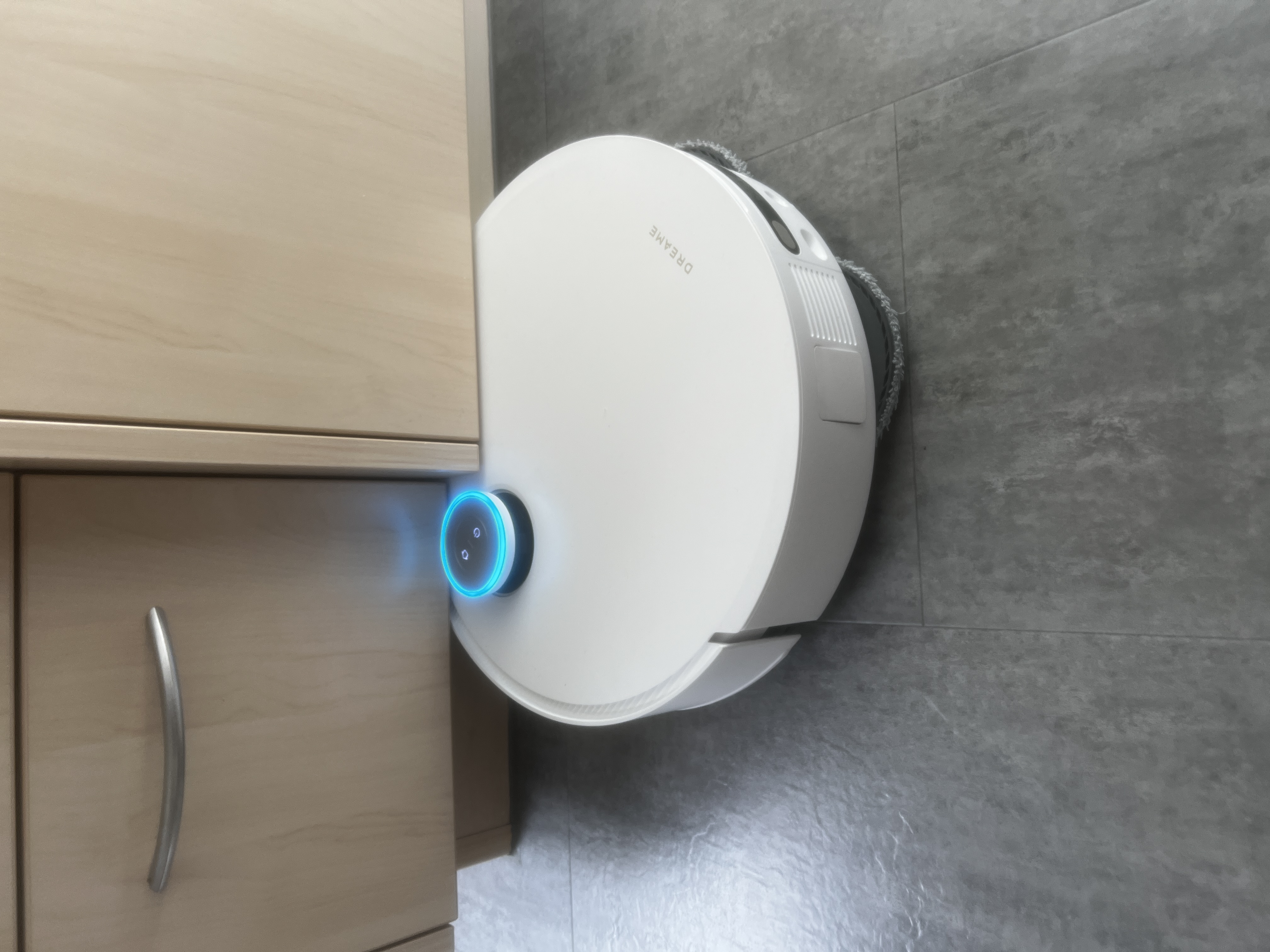

Basically I’m happy with the robot.

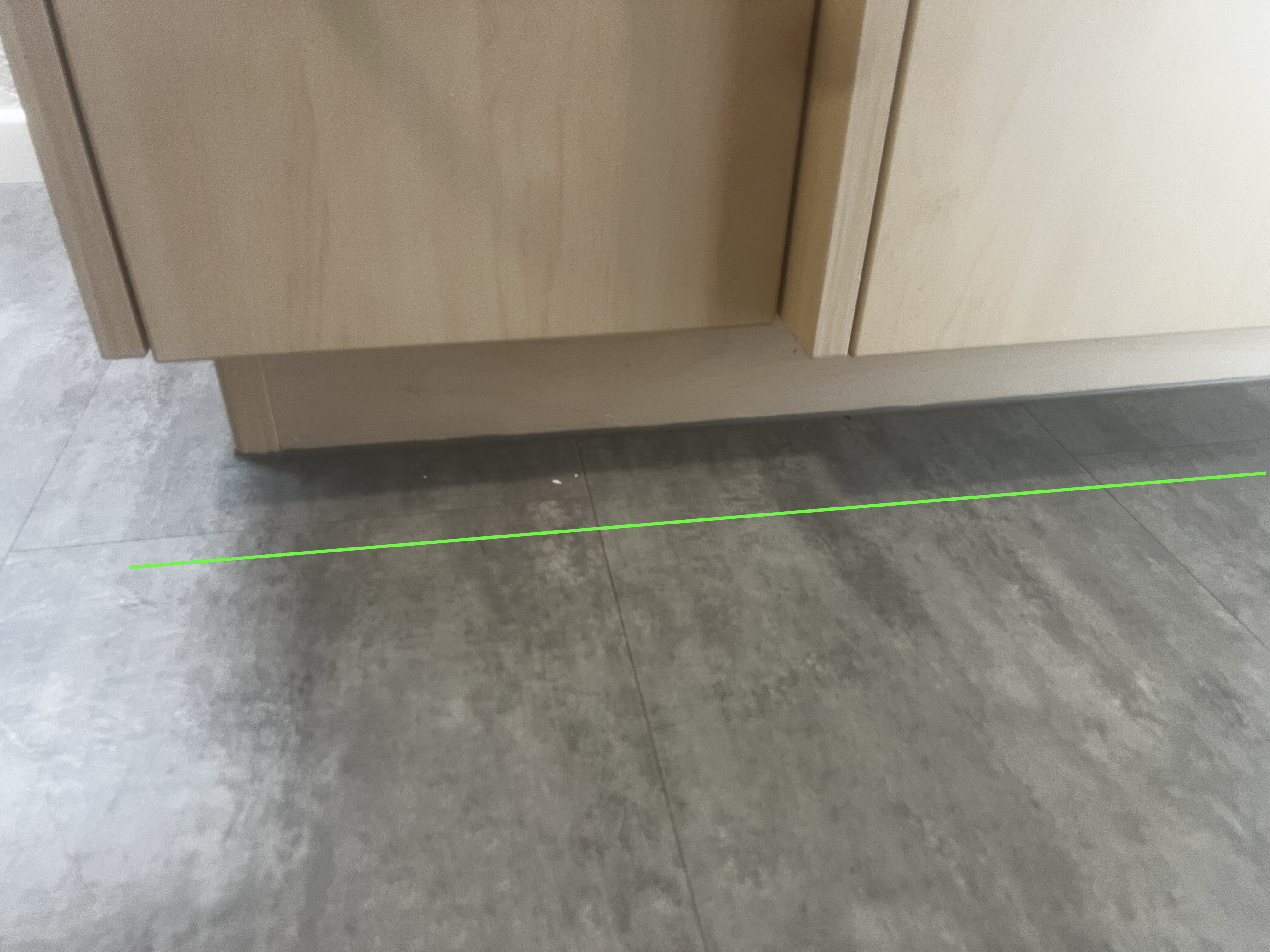

The robot would actually fit under the furniture (I manually placed it there for demonstration) but it does not go there for no reason ( it only cleans to the green line). Also it will not use the MobExtend and SideReach AI features to go there.
How do i get the robot to clean under this furniture?
Dear GZ355291,
Hello, regarding the issue you mentioned with the X50 Ultra Complete, our devices can enter spaces with a height of 98-120 mm with the LDS lowered. We usually recommend that the space be 1-2 cm higher than the device. Please also check if the LDS can be adjusted (lowered or raised) after setting the following two points in the app:
Settings >> Automatically Raise LDS
Settings >> More Features >> Remote Control >> Raise LDS
If you need further assistance, please provide your ticket number or contact us via: "Me > Help & Feedback > Contact Us > Online Customer Service".
3-6-2025 09:15:11 DE Übersetzen
GZ355291 Themenstarter
Thank you, with LDS set to extreme coverage it goes below, even tho the height is only 93mm.
