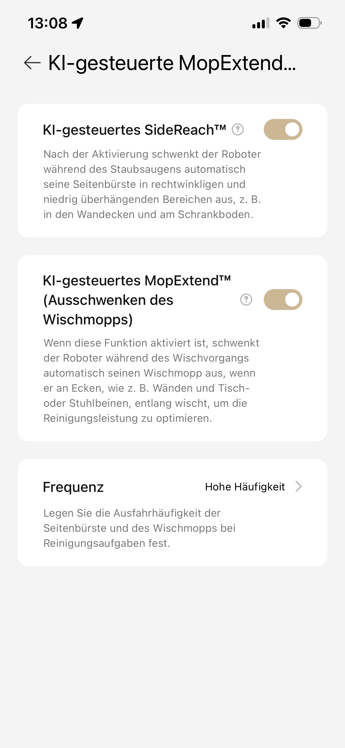

SK535538 Themenstarter
here sre my settings, the video i cannot upload here
I have the same issue. Noticed that it worked before but after the latest firmware update the robot is not really using the functionality to extend the brush and/or the roller. I have the same settings like you - everything enabled in the AI SideReachTM section

I fixed it for me. Maybe it helps others. I deactivated all the features and activated them again. Now the robot is using everything like he/she should.
